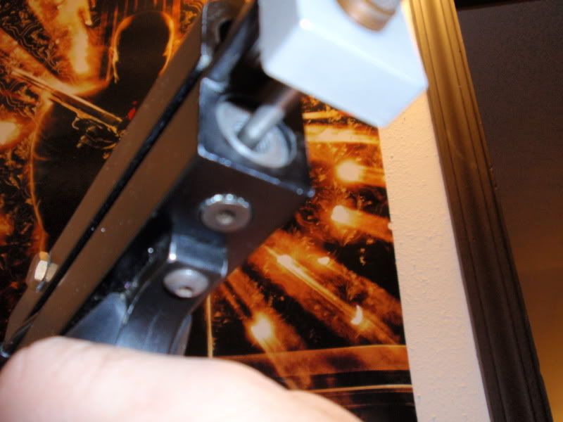

PostPosted: Thu Aug 19, 2010 3:12 am    Post subject: Re: autococker pumps
pump wrote:
just the adjustment hole is through the top, take a pic above the top of the marker showing me the sight rail, it will show a hole if there is one
take a pic of the bottom tube of the body with the backblock cocked back, that will show what type of adjuster you have and me what springs you have.
your LPR is an old Rock, its adjustable
the bolt is sweet
you might just need to replace seals and shell work fine
or you can go overboard on many different levels

PostPosted: Thu Aug 19, 2010 3:25 am    Post subject: Re: autococker pumps
yep PPS rock, but looks like the paint/anno is gone...shine it! woot
ok there should be a hole in the middle of the sight rail for the hammer lug adjustment
and the bottom tube, i need to see in that dark hole...but odds are its a non nelson hammer kit, since the hole in the sight rail is not there
you do no need a nelson spring kit as long as you can find a spring that is light enough any spring size as long as it fits in the hammer will work perfect, BUT you would also need to use a lighter valve spring and a regulator.
if your willing to wait ill be finding a screw that is threaded for the hammer, but having an unthreaded shoulder, THAT has a allen key adjustment hole that is not too big...been tricky for me
but if you want to cut it up you can its up to you on how far you want to take it

PostPosted: Fri Aug 20, 2010 1:51 am    Post subject: Re: autococker pumps
ok. i turned the rock all the way off and when i turn it on slightly, the leak appears to be coming out of the base of the 3 way and when i hold the trigger down, it vents from the front of the 3 way.
how do i get the 3 way off to fix it?

PostPosted: Fri Aug 20, 2010 3:29 am    Post subject: Re: autococker pumps
take off the hoses , loosen the timing rod, and unscrew it
if the LPR is in the way(which it probably is) youll need to unscrew that from the frontblock
then you can pull out the 3way rod and check the orings
if they are bad replace, if they are ok its the 3way rod spacer thingys that need replacing
