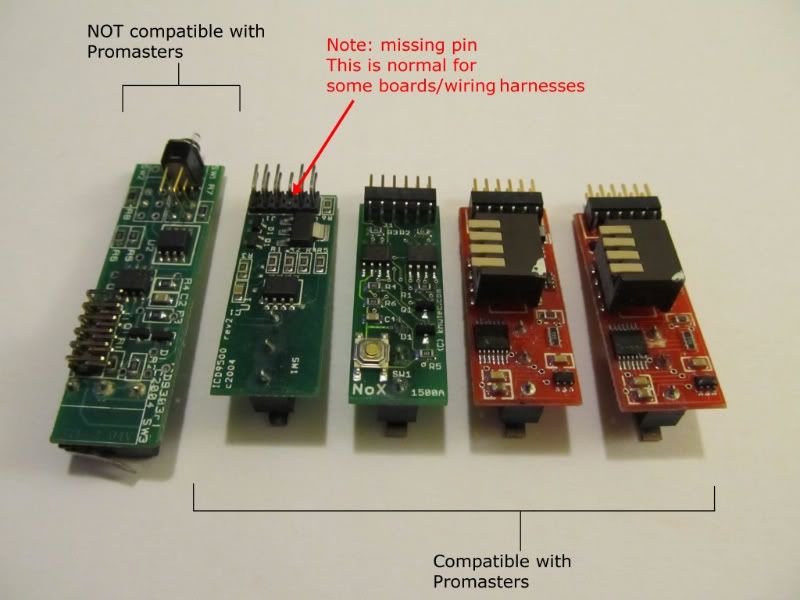

Some boards had a certain pin broken off because the wiring harness had a 'blank' connection at that location. The board may work fine despite the broken pin.
Here's a pic of some boards and one has the broken pin. If your broken pin is in the same location it might just work okay.

Oh snap. I did not even think of the missing pin. Good catch.

Interesting about the board. There is something soldered into that hole, i just figured it was broke Shocked
